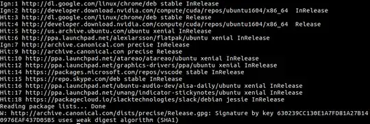

UPDATE: sudo apt-get update runs without errors now but I'm wondering if these updates are enough?
update output

You have to disable the problematic repositories by using Software & Updates (software-properties-gtk).
You need to open Other software tab and then disable the following repositories:
  • http://archive.canonical.com/dists/precise (as your distro is 16.04 LTS that is Xenial Xerus)
  • https://packagecloud.io/computology/apt-backport/ubuntu (even the browser says 404 for this page)
  • http://ppa.launchpad.net/picaso/octave/ubuntu (it does not provide packages for versions after Lucid Lynx 10.04 LTS)
and then confirm reloading package caches.
If issue persists - please run sudo apt-get update manually and add error output to the question. I'm ready to assist you more if any.
