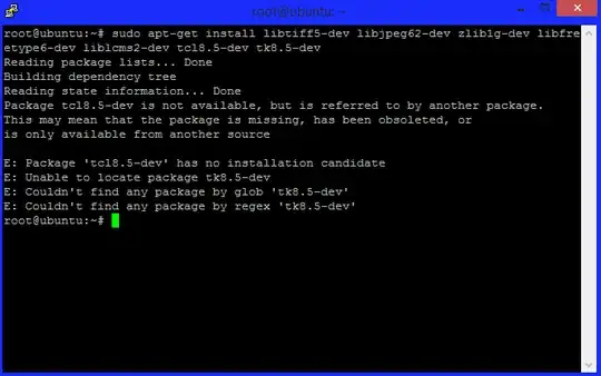

i am trying to install pillow and for that purpose i need to run this command for the dependencies ,
sudo apt-get install libtiff5-dev libjpeg62-dev zlib1g-dev libfreetype6-dev liblcms2-dev tcl8.5-dev tk8.5-dev
but it gives me this error:

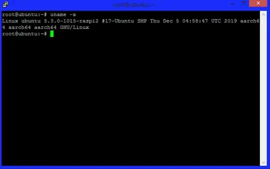

would someone help me out ? my ubuntu OS is running on raspberry pi installed from here
System details:

As far I can understand your Ubuntu version is 19.10, so it has tcl8.6 in the repositories.
So you have to install these packages:
sudo apt-get install tcl8.6-dev tk8.6-dev
or simplier -
sudo apt-get install tcl-dev tk-dev
Also I'd recommend to change TIFF and JPEG package names to the following:
sudo apt-get install libtiff-dev libjpeg-dev
