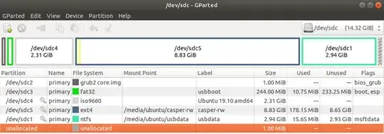

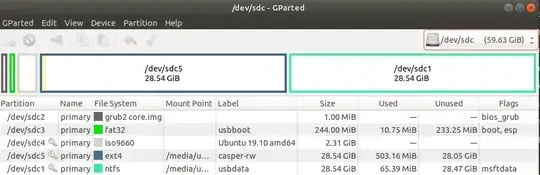

After following the instructions, I seem to have a USB drive formatted by mkusb as predicted. When I attempt to boot, the BIOS/UEFI process identifies the USB stick as a possible boot location, but when I select it for booting and proceed, I am returned to the same screen for choosing a boot location. For some reason, the USB stick is rejected as a viable boot option. I have tried the process 3-4 times using 2 iso images (18.04LTS and 19.10) and 2 USB sticks (Sandisk Extreme 64GB and Sandisk Cruzer Facet 16GB). Below are links to two screenshots of GParted analysis of the resulting USB sticks.
  1. https://drive.google.com/file/d/1HjyLS2QoHXW2U3pdg_RETof9PBSnwYDV/view?usp=sharing
  2. https://drive.google.com/file/d/15ISNR48hRilpvztyaOxrKXSigAQKZ_Ho/view?usp=sharing
