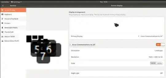

I use 7 monitors: in a 3 over + 3 under +1 portrait configuration. GNOME Display Arrangement draws 7 very tiny monitor icons with a huge amount of white space. The icons are so small that I cannot reliably rearrange them. I can hardly even select them or move them around. Is there a fix for this issue?

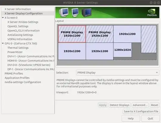

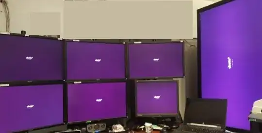

Aside from that, video displays very nicely on all monitors and there are no other issues. I'm using onboard Intel video and PCIe Nvidia GTX 760. I have included a Display Arrangement screenshot, and also magnified the tiny icons for comparison. Its quite chaotic. There is also a pic of the actual monitors, and finally the Nvidia X Server Settings.
I have reviewed the GNOME monitors.xml file and found 2 duplicate entries and deleted them. It did not resolve the issue. Even if I disable all of the monitors then re-enable them one by one, by the time the 5th and 6th monitors are enabled the icons are almost too small to rearrange.
Display Arrangement very small
actual monitors
NVIDIA X Server Settings
