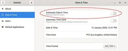

One visual side effect of this problem can be seen in the Date & Time settings panel. You can't enable "Automatic Date & Time". The switch flips back to disabled.
However, ntp still does the time synchronization with the various ntp servers.
This can be fixed by uninstalling ntp, ntpdate, and sntp, and letting systemd-timesyncd.service perform the time synchronization.
