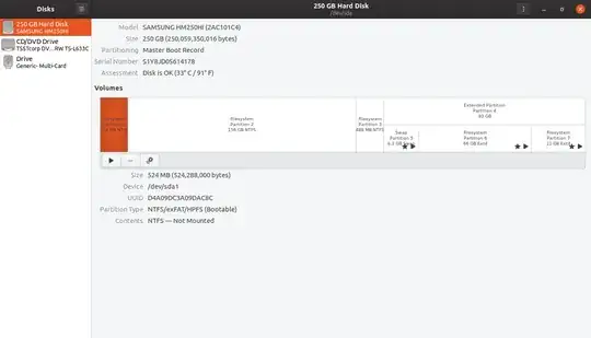

The screenshot of "Disks" from comments:

I guarantee you that Windows driver ext2fsd corrupted your Ubuntu file system. Uninstall it asap.
Let's see if we can recover your Ubuntu file system...
For 18.04 or newer...
  • boot to a Ubuntu Live DVD/USB
  • open a terminal window by pressing Ctrl+Alt+T
  • type sudo fdisk -l
  • identify the /dev/sdXX device name for your "Linux Filesystem"
  • type sudo fsck -f /dev/sdXX, replacing sdXX with the number you found earlier
    • sudo fsck -f /dev/sda6
    • sudo fsck -f /dev/sda7
  • repeat the fsck command if there were errors
  • type reboot
