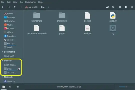

https://help.ubuntu.com/community/MountingWindowsPartitions explains the facts in detail. In your case, almost certainly, Windows 7 partitioned and formatted the hard drive using NTFS, and Ubuntu knows how to read and write files in an NTFS partition, automatically using ntfs-3g, as confirmed here.
Take a look at this tutorial which shows what happens when you open Files and look for the NTFS partition of Windows 7; it will appear in the yellow box of the picture below (although the colors will be different). Files app showing other partitions
