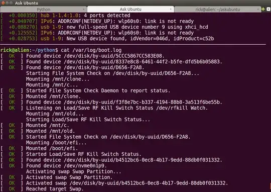

To those that do not know, the advantage of /var/log/boot.log over journalctl -b is the color formatting that mirrors the console boot messages:
