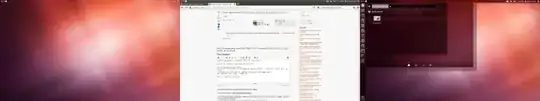

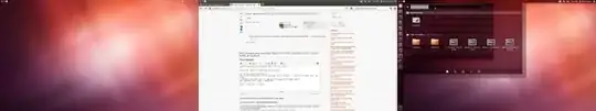

Before
before After
To revert the change simply:
sudo mv files.lense.ignore files.lense && unity --replace &
