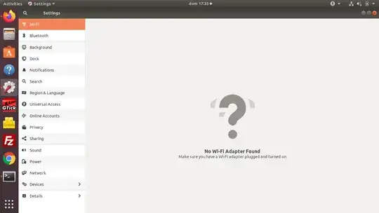

I'm trying to figure out how to re-activate the Wi-Fi options in Ubuntu 18.04.02 Desktop Settings:
As you can see from the screenshot I've taken, there is no on/off button for wifi.
I followed the indications found here: No wifi option on Ubuntu (18.04 and 16.04) but without success ...
