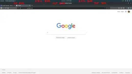

I'd like to combine the shell bar and the top bar on my desktop for all applications.
I have noted on the screenshot below what I mean by shell bar and top bar.
