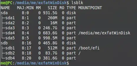

sda is the internal (Windows) disk.
sdb is an external SSD w/Linux.
lsblk output, showing mounted partition
directory listing in exfat partition

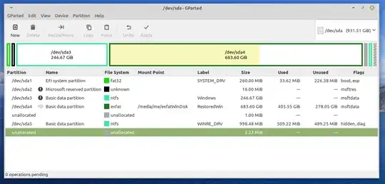

GParted, showing 400GB is used

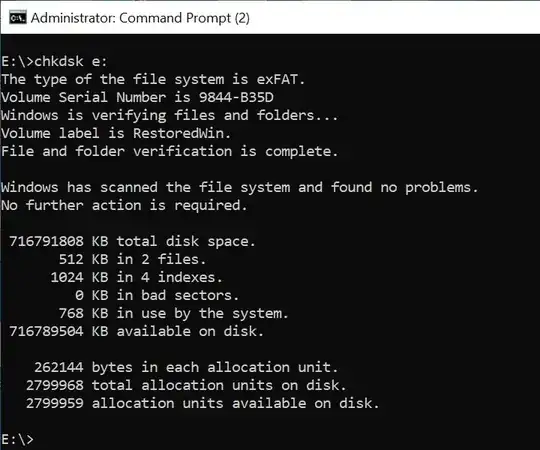

Now, run chkdsk, without selecting to repair the partition.
Output of chkdsk, no files, no errors.

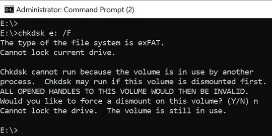

Now, select repair. (Because I'm about to give up anyway, and rerun PhotoRec with this partition formatted as NTSF)
Windows says the partition is locked, I deny forcing a remount
Windows says the partition is locked. Now I'm going back to Linux.
