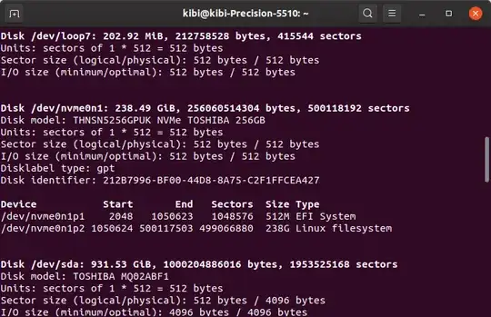

EDIT: adding a screenshot showing where the EFI is this is where the EFI partition is, is it ok?
