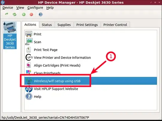

Then launch the hplip-gui and choose the network printer, afterwards select Wireless/wifi setup using USB as the following image shows:

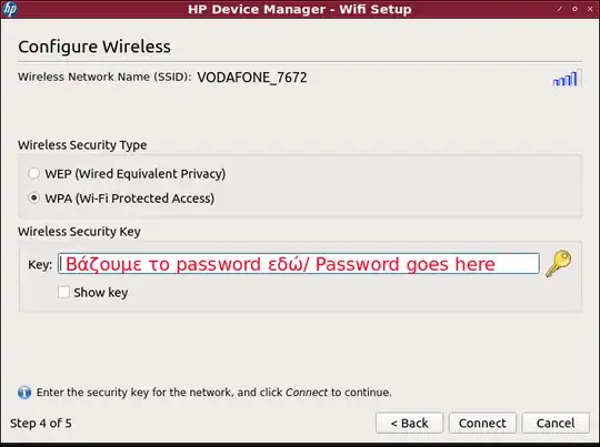

Then, on the next screen, enter the password for the wifi network:
Then press Connect in case of a wrong password try again by pressing back.

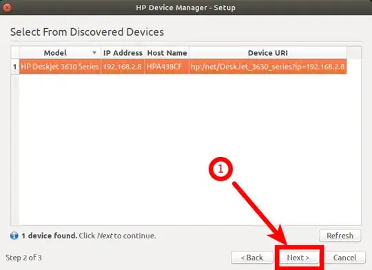

As you can see from image above via the hp-setup followed by your printer's ip you are able to add your printer as network one.
This command is applicable for any GNU/Linux machine in your network that has hplip installed, as long as the printer is turned on.

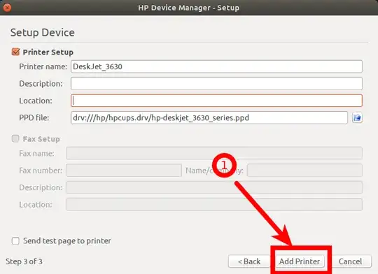

Once the command given adding the printer is pretty much trivial as the following images show:
