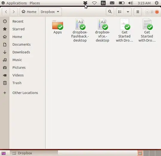

To get Dropbox icons on Nautilus you have to install nautilus-dropbox package:
sudo add-apt-repository multiverse
sudo apt-get install nautilus-dropbox
Then logout (or reboot) and login back.
As the result you will get icons in Nautilus and Dropbox icon on GNOME panel. See screenshot below from GNOME FlashBack session:
result of Nautilus Dropbox package installation
