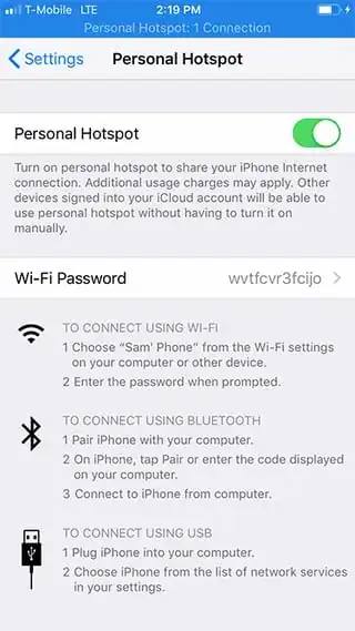

You could try to use USB tethering.
  1. Connect your phone to PC with Ubuntu.
  2. Go to Settings -> More -> USB tethering (If you have Android device)
or on iPhone, go to Settings -> Personal Hotspot as seen below
iphone settings
