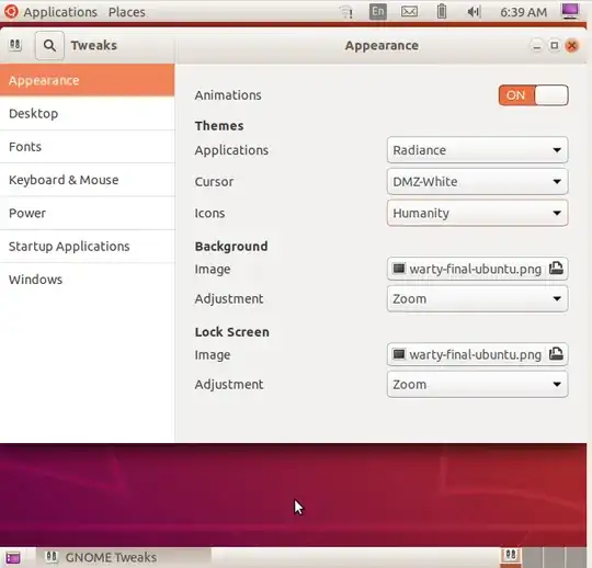

Install Gnome Tweaks (sudo apt-get install gnome-tweaks). It allows you to change the icon theme.
You may need to change to
  • a "Light" variant of the Humanity icon theme:
    Humanity

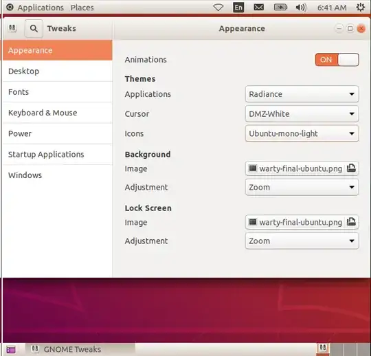

  • or "Ubuntu-mono-light" with darker icons:
    Ubuntu-mono-light
