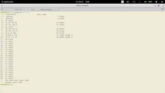

The download speed in Terminal is very slow. about 40kBytes. But the speed in the browser works fine I have chosen the best server but I still get the problem by the way loot at the output of tracepath 1.1.1.1 output if it helps:enter image description here
