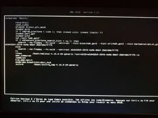

I tried, I have this:
grub_cmd_blacklist
The command already appears but all on one line, so I just put carriage returns between them.
Now my onboard USB3 controller is disabled ( I've tried to put a USB device on it and it is realy disabled ) but not my added one.

Note : now my grub file is (and it make what I describe above persistant) :
/etc/default/grub
GRUB_CMDLINE_LINUX="amd_iommu=on iommu=pt kvm_amd.npt=1"
GRUB_CMDLINE_LINUX="modprobe.blacklist=xhci_hcd"

Can you bring up the GRUB boot menu and edit the command line options similar to what the @matsuzaki did in this post?
If so, then you may be able to add the blacklist, modprobe.blacklist=xhci_hcd, in as a parameter.
According to this post you may want to try F1 to bring up the boot menu: askubuntu.com/questions/1014626/how-to-access-grub-menu
