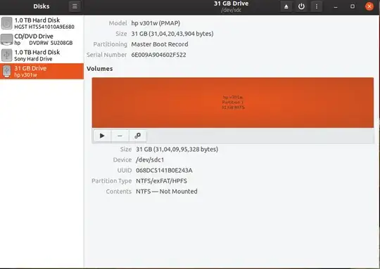

Recently,I bought a pen drive:hp flash drive v301w.It was working fine when I first used it but when I formatted it,it does not appear on Files anymore, but it appears in Disks: enter image description here

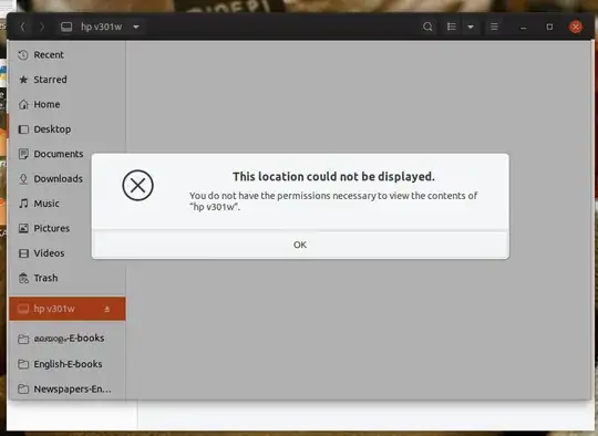

Then I created a partition in the name hp v301w.After that it does appear in Files but then this message pops up:

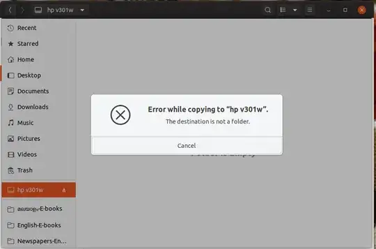

When I tried to copy a file into the pen drive,this screen appears:

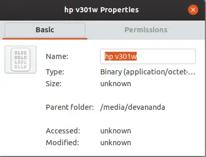

The properties of the pen drive are:
The permissions state that: "The Permissions of "hp v301w" could not be determined."

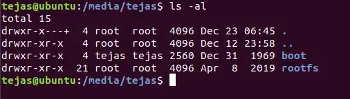

This problem can occur sometimes
Step 1: Press Ctrl Alt t to open terminal. Step 2: Connect the USB and go to /media/<user> where <user> is your user name. Paste the command in the terminal
cd /media/devananda
Step 3: Type ls -al and see if the USB mount point is owned by root.
screenshot
Step 4: If it is owned by `root, then, type
sudo chown [username]:[username] [mount point]
and enter your password when asked
