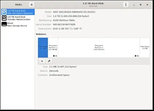

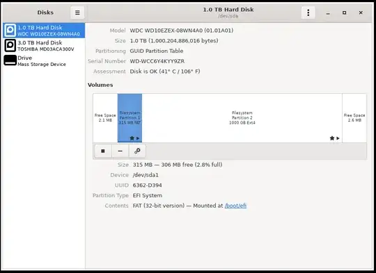

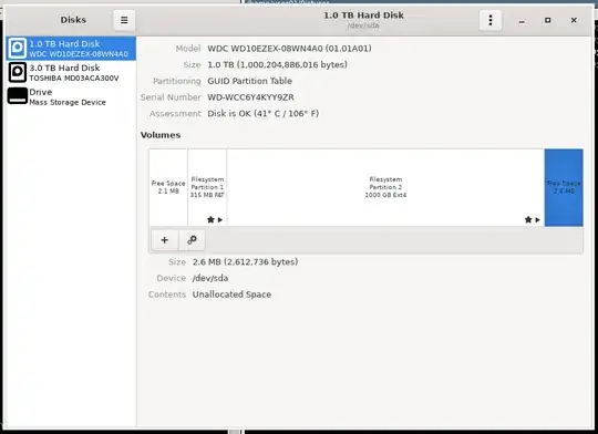

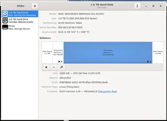

Here I show the information shown by Disks for each disk and partition: 1TB disk, space before partitions 1TB disk, partition 1 1TB disk, partition 2 1TB disk, space after partitions 3TB disk, only partition (notice it is not mounted)
