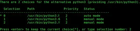

Step 2: Add Python 3.6 & Python 3.8 to update-alternatives
sudo update-alternatives --install /usr/bin/python3 python3 /usr/bin/python3.6.9
sudo update-alternatives --install /usr/bin/python3 python3 /usr/bin/python3.8.1
Step 3: Update Python 3 to point to Python 3.7
By default, Python 3.6 is pointed to Python 3. So, we run python3 it will execute as python3.6 but we want to execute this as python3.8
sudo update-alternatives --config python3
versions You should get a similar output. Now type 2 and hit enter for Python 3.
Step 4: Test the version of python
Finally test the current version of python by typing
python3 -V
