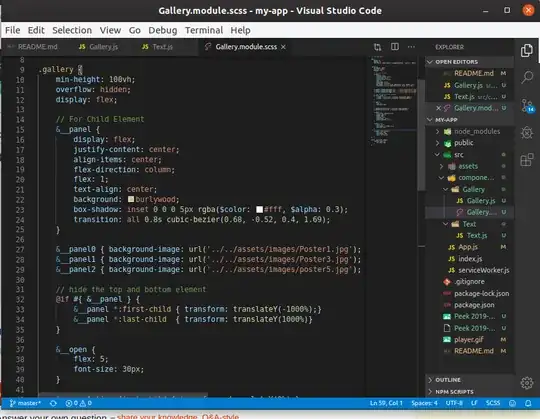

The VS Code UI has been changed in 19.10 and it's not good as it was in 19.04 and earlier. The menu bar in VS Code deviates from the Ubuntu 19.10 system theme, and it has a disconcerting white background instead of being dark. The VS Code UI also deviates from the default system theme in a few other minor ways. This mismatched UI is annoying to someone who uses Visual Studio Code on a daily basis, and it's no longer possible to save slick looking screenshots of my code.
Is there any way to get a decent looking UI back in Visual Studio Code?

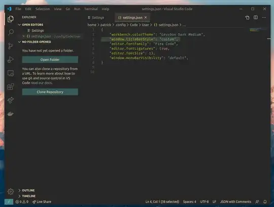

Open your settings.json and add the following:
    "window.titleBarStyle": "custom",
VS-Code will then prompt for a restart of the application. With GruvBox theme this was the result:
vs-code screenshot

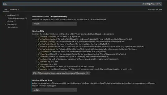

Open Settings and search for Title Bar Style. Changing that option to custom could possibly fix this issue.
