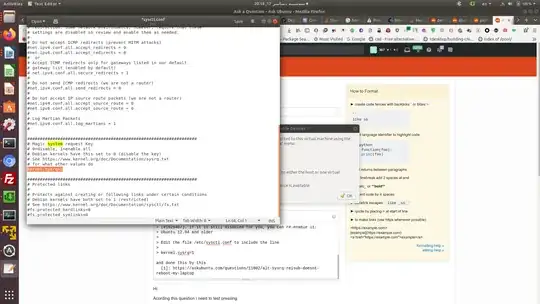

so i read this:
Alt+SysRq has been disabled to fix a bug. The disabling of Magic-SysRq was considered a bug itself and it has since been re-enabled (#1025467). If it is still disabled for you, you can re-enable it: Ubuntu 12.04 and older
Edit the file /etc/sysctl.conf to include the line
kernel.sysrq=1
and done this by this kind:

It seems that you've already enabled it - so the problem is likely you not being able to press it, or not pressing it correctly, due to your keyboard.
SysRQ is labelled Print Screen or PrtScron many keyboards, and on some others you have to press Fn to access it, making the full combination of keysAltFnPrtScrF
There's also another great solution:
sudo apt install earlyoom
With that installed, you may never have to press it.
