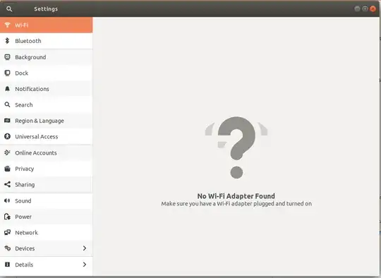

I have a Thinkpad X1 carbon 7th gen with an Intel 9560 wireless card. When I installed the Ubuntu 18.04 I noticed the wireless does not work.
My Wireless Situatio!

And here are the results of iwconfig:
enp0s31f6  no wireless extensions.
lo        no wireless extensions.
enxc025e9292f1d  no wireless extensions.
I also updated & upgraded all packages of my Linux.
How can I fix this issue? Any Ideas?
