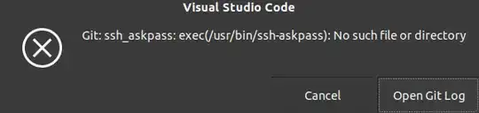

Don't know what happened. But all of sudden I can't push updates in GitHub. A month ago I used SSH keys to integrate VS Code with Github so that I do not have to type email & password every single time when I use to push updates to the Git repository.
I think BleachBit has deleted some important files and this is happening. But this is my wild guess. I can't confirm this. Because I didn't do anything other than that. VS Code used to work fine. Suddenly this is happening. I gotta be careful with Bleachbit if this is an act of Bleachbit. Screenshot of the error message.
Meanwhile, I am going nuts over for a week thinking how to solve this issue. If you had this issue, then do comment it out.
When I did ls /usr/bin/ssh-askpass, it say there is no file or folder. This might be the cause of the problem. But I do see these folders inside /usr/bin related to ssh: ssh ssh-add //is a file that supposed to be deleted when I unistalled ssh-askpass ssh-agent //is a file ssh-argv0 ssh-copy-id ssh-keygen ssh-keyscan

I had to do 2 things to get this solved.
  1. As @Wan-Chap said above
     sudo apt install ssh-askpass
  2. Use this command to add bitbucket.org (In my case it was Bitbucket)
     ssh-keyscan -t rsa bitbucket.org >> ~/.ssh/known_hosts
It seems your ssh-askpass is missing. Just re-install it by:

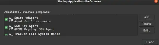

Well, I think (& am 100%) I found my solution. If you use services like SSH keys, make sure you don't disable SSH Key Agent. It was a stupid mistake. A week ago, I tried to decrease my boot time by disabling all unwanted services that launch itself while booting. I read askubuntu post asked by someone to disable those services. Now I have realized it.
Screenshot
Lesson learned. Don't do anything which you know don't for sure. Try not to disable other startup services related to SSH if you depend on it. After enabling the service, you might have to reboot. Then you are good to go.
