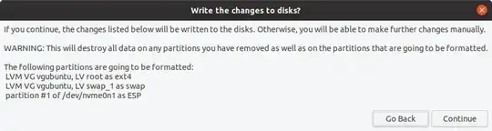

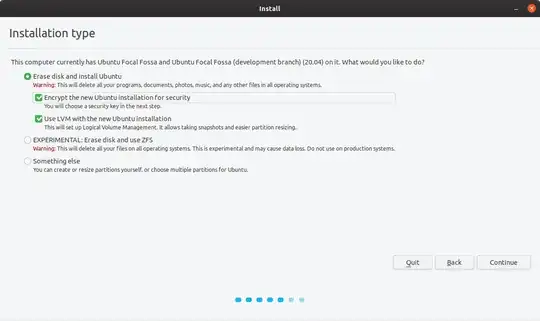

  • In the installer, at the partitioning window 'Installation type', select Erase disk and install Ubuntu
  • Encrypt the new Ubuntu installation for security
  • Write the changes to the target drive
  • Continue with the installation

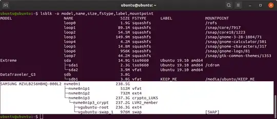

    The partition structure seen from the live system after installation shows that there is LVM with LUKS encryption.
  • After reboot you must enter the passphrase, that should be long, difficult to guess but easy for you to remember.

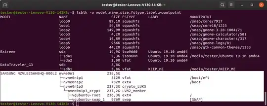

  • This is the partition structure seen from the installed system,
