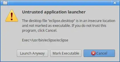

Double-clicking on desktop icon:
Selecting Launch anyway does nothing (visible to me).
Selecting Mark Executable gives:
~/Desktop# ls -l eclipse.desktop
-rwxrwxr-x 1 geri geri 195 Dez 12 13:37 eclipse.desktop
Double-clicking on desktop icon now does nothing (visible to me).
