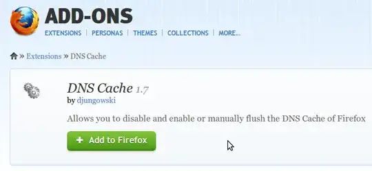

To find out if Firefox is being bad with DNS Cache you can install an Add-on to check DNS Cache in Firefox. the one I recommend is DNS Cache.
After restarting Firefox you should see a cog in the bottom (Similar to the Ubuntu cog in the upper right corner). You can left-click or right-click the Cog and you should see options like Enable/Disable DNS and Flush it. This will help in the case of the problem being the Firefox DNS Cache. Play with it.
