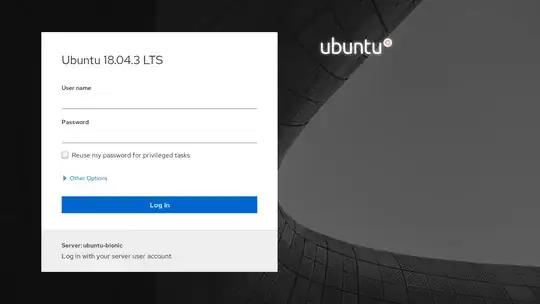

This is the Cockpit login page. It uses the /etc/passwd and /etc/shadow file for the user credentials. Use the credentials of one of the Linux users to login.

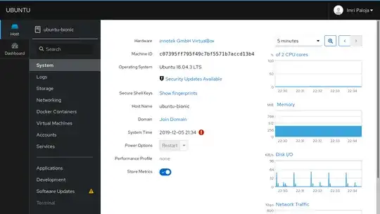

After login you see the /system page, which is an overview of your server. From here, you can browse and click around on what you want to do on your Linux system. Most of this is self explanatory, you will need to have some technical know-how to keep you from mucking up your server, though.

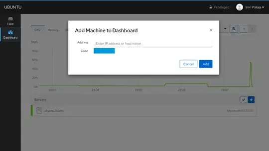

The Cockpit dashboard plugin allows you to add other Linux servers - with Cockpit - to a server with the cockpit-dashboard plugin installed. There in you can click on any of the servers and manage them from there.
