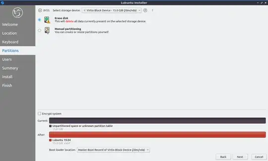

Edit2: I think I am much better informed now. Just in case, I am showing here exactly what I see and I would like to know if my reasoning is right: 1) these are the options I have when trying to install Lubuntu 19.10: enter image description here

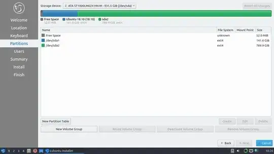

2) This is how I see my HD from the installer (the bigger partition is my data): enter image description here

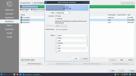

3) when I click 'Edit' with the current Lubuntu partition selected, I see this: enter image description here

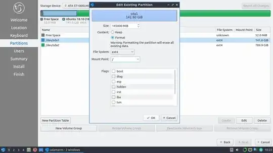

4) so please advice me are this options the appropriated ones to install Lubuntu 19.10 over my current Lubuntu, and leave my data partition untouched?: enter image description here

As you have done in the picture below, select /dev/sda assuming that is the Ubuntu system partition mounted as /.
  1. under Content select the Format button (as above).
Note: This will erase everything in your /home/$USER folder unless it is in the second partition. If you want to keep your documents, music, photos in the /home/$USER folder then select keep button. If you decide to format the system partition you can always restore the contents of the /home/$USER folder from backups.
  1. Select File System ext4 (as above).
  2. Select Mount Point / (as above).
  3. Leave Flags as is. No special flag are needed.
Click OK.
Make sure your data partition is untouched.
  1. under Content select the Keep button (This is the important part).
If you had used /home as the mount point of your data partition in the existing installation, then:
  1. Select Mount Point /home (Don't do this unless you are sure you have been using the second partition as your /home).
You may not have to edit your second partition details unless you had /home there. If so, you can hit Cancel and keep everything as is for /dev/sda2.
Click Next at the bottom right of the screen and continue with the installation.

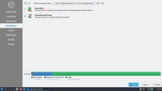

If it was me, I'd use "Manual Partitioning" enter image description here
Picture from the manual page you already referenced, but please select Manual Partitioning not what is shown
Select your existing partitions, plus ensure "Format" is unticked.
It'll cause the installer to take note of your software, erase system directories, install, then add-back your additional packages (if available in new release) without touching your data (unless you have format ticked).
