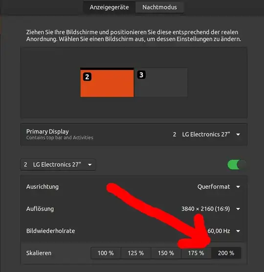

I have two 4k monitors one called DP-4, the other DP-2 (plus the Laptop's internal display). Using xrandr (or another command line tool) I would like to arrange them as in the following and also set the scaling to 200%:
screenshot showing monitors as I want them
This almost works with this command:
xrandr \
  --output "DP-4" --primary --pos "0x0"  \
  --output "DP-2" --pos "3840x0" \
  --output eDP-1-1 --off
The only thing not working is setting the scaling of both DP-4 and DP-2 to 200% with xrandr. How can I do this?

You are just missing the --scale 2x2 argument. So use:
xrandr \
  --output DP-4 --primary --pos 0x0 --scale 2x2 \
  --output DP-2 --pos 3840x0 --scale 2x2 \
