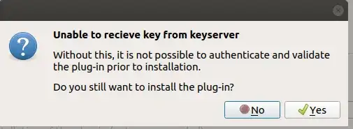

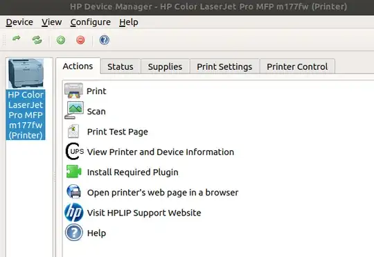

UPDATE: After following the uninstall solution from @N0rbert and below from @Feliepe G. M. Maia, I was able to get 3.17.10 to install. Now the plugin won't install. The first attempts said a successful completion, but if I tried to use the scanner the plugin was said not to be installed. I've tried hp-plugin, python3 $(which hp-doctor), and through the GUI as below. I'm now getting a message about not being able to verify the key server. No luck after a reboot. GUI Key server error
