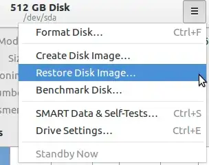

As far I can see on my Ubuntu 16.04 LTS system - the GNOME Disks utility allow to restore disk image in GUI way:
  1. Select target drive.
  2. Click on hamburger button, and then select Restore Disk Image
    GNOME Disks

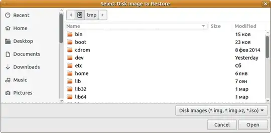

  3. Then it will ask the path of image file:
    Select Disk Image to restore
    here you can select any of *.img, *.img.xz (sic!) and *.iso formats.
