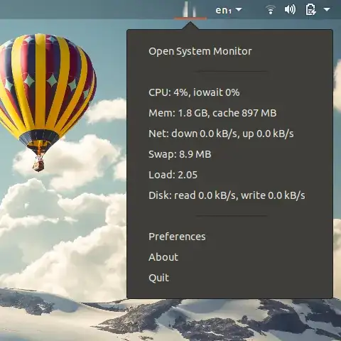

I have a 4GB RAM laptop. During last week, my system was freezing a lot. When I checked the stats, it said 2 GB or RAM and 1 GB cache is in use. The load is some 1.2 or similar. So I reinstalled 18.04 and a couple of regular programs. But even with everything closed, the zero used session still shows 2 GB RAM consumption is system load indicator. Please check the screenshot below.
I want to know whether this a normal thing or I should be worried about my hardware. Thanks.

But even with everything closed, the zero used session still shows 2 GB RAM consumption is system load indicator . . . I want to know whether this a normal thing or I should be worried about my hardware. Thanks.
I think this is normal because my system also has the same memory usage. I currently have nothing running and my memory use is 2.0 GB, cache 1.8 GB but I also have 4 GB of swap space (2 GB swapfile and 2 GB zram) and my swappiness is set to 10.

System memory usage and memory allocation are adjusted depending on available memory of the system on the specific hardware. Depending on many variables, the actual used memory may differ from system to system. In general as long as the system is not running out of memory, having a higher than expected memory usage is not something to worry about.
