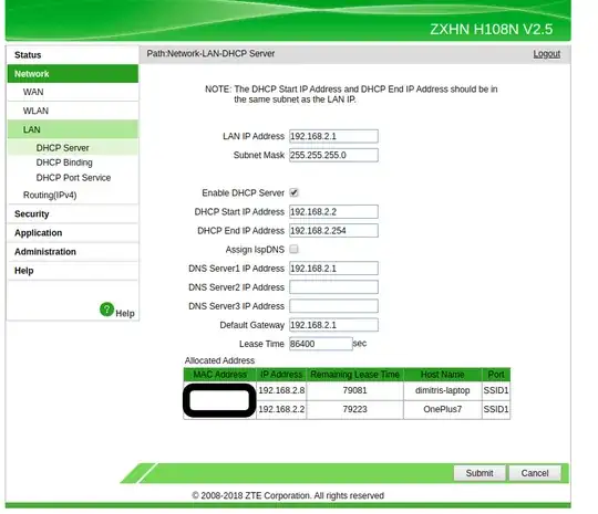

Here a screenshot of my rooter configurations in case there are some wrong defined configs
