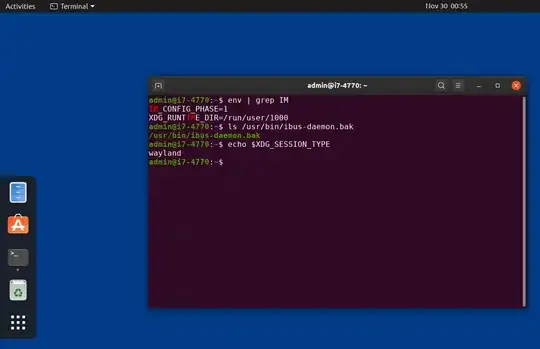

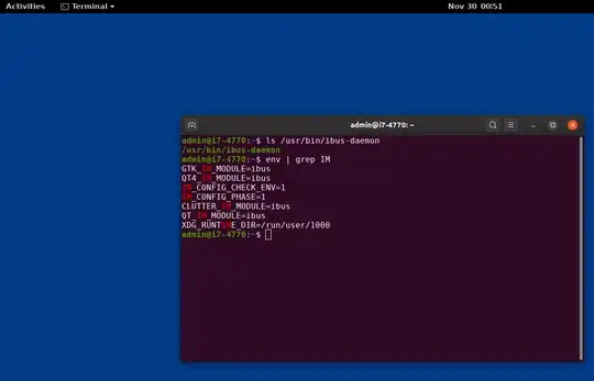

By default in Ubuntu 19.10 /usr/bin/ibus-daemon exists. so the command will not be executed.
env IM_CONFIG_CHECK_ENV=1 im-launch true
when there is the file /usr/bin/ibus-daemon and my session is x11
here is something about IM
when there is no file /usr/bin/ibus-daemon and my session is wayland
here is the thing which is different from above, which means the env is applied and then a chain reaction followed.
so, if you disable or enable this from startup list nothing happens unless no existence of this file /usr/bin/ibus-daemon and your session is wayland conditions are met.
