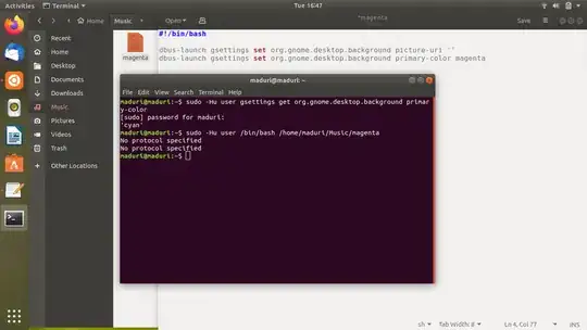

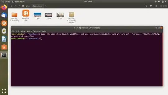

the reason is you are not using dbus-launch infront of gsettings command.
see man dbus-launch
if you run sudo -Hu user gsettings set org.gnome.desktop.background picture-uri '' you will get error
administrator@pratap:~/Music$ sudo -Hu user gsettings set org.gnome.desktop.background picture-uri ''
(process:11889): dconf-WARNING **: 18:54:53.409: failed to commit changes to dconf: Error spawning command line “dbus-launch --autolaunch=454398a8b6e94accb53d9b7e5361faaa --binary-syntax --close-stderr”: Child process exited with code 1
