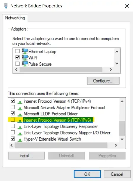

In my case, none of above solutions working for me.
In the end, I've disabled Internet Protocol Version 6 (TCP/IPv6) in WLAN Properties of Network Connections Settings. The DNS working again somehow.
Configuration Screenshot:
Screenshot of Disabling Internet Protocol Version 6 (TCP/IPv6)
