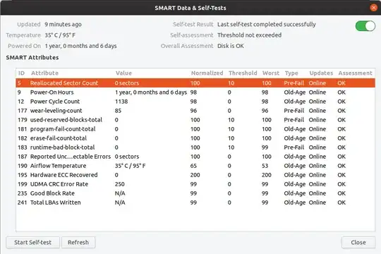

I have experienced with some apps, like Filezilla or Hexchat, that the loading times are obscene.
Look at this video. Trying to open up Filezilla, with syslog in the background and a timer. It takes about 30 seconds!
Webm: https://webm.red/5cq4.webm
Why could this be happening?? I am not using snaps, by the way.
