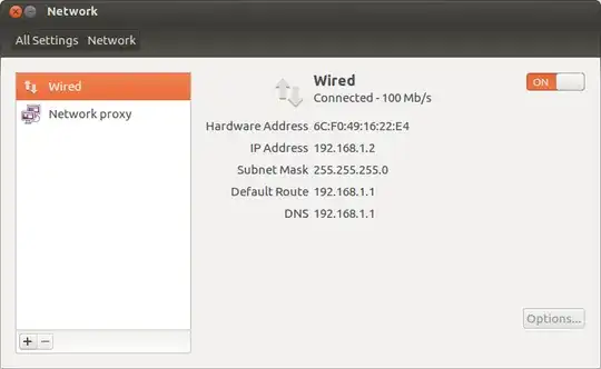

Additionally please check that in Network in System Settings the interfaces listed on the left have ON toggled for Wired and Wireless. I am using Wired, so only one is showing. In your case both should show
