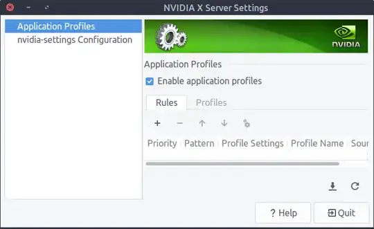

You can also try by opening the Nvidia X Server Settings, in my case it wasn't recognizing any screen to configure
So I opened it in the terminal to see if there was any error, nvidia-settings, and I found this:
ERROR: nvidia-settings could not find the registry key file or the X server is not accessible. This file should have been installed along with this driver at /usr/share/nvidia/nvidia-application-profiles-key-documentation
After searching I arrived to this link which suggested this:
cd /usr/share/nvidia
ls -la
Now you will see a profile file with this format: nvidia-application-profiles-*.*.*-key-documentation. Now let's make a symbolic link to the expected filename by nvidia-settings
sudo ln -s \
nvidia-application-profiles-470.57.02-key-documentation \
Change the version numbers with the ones you have, and now execute:
sudo nvidia-smi
