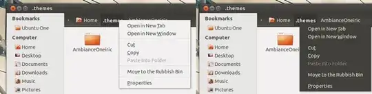

In 12.04 Ambiance theme, the default right click menu color changed from black to white.
From this bug-report, it appears this decision is by design
But I love black only. How can I change it to black?
Screenshot

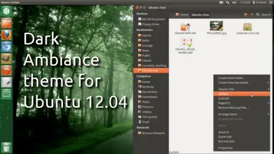

Stan Angeloff has created a theme that requires the use of ubuntu-tweak or gnome-tweak-tool (i used the former) to enable. Check this link:

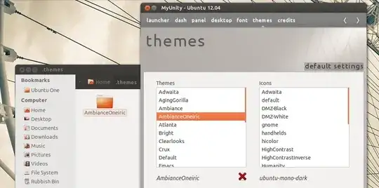

As per omgubuntu
you can use this tweaked ambiance for 12.04
To make use of Ambiance Oneiric hit the button above to download the .zip file. Then extract the .zip archive in to the ‘.themes’ folder in your Home directory (tip: you’ll need to press CTRL+H to reveal hidden files).
Then apply the theme use myunity
THE RESULT enter image description here
