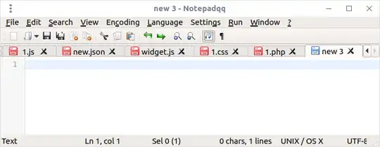

I'm looking for a way to move the application menu in the window's title bar on the left side as it is illustrated on the next image.
Optionally, I will be happy if there is some way to force such application menu to appear for non-GTK windows as Firefox, Chromium, GIMP, etc.

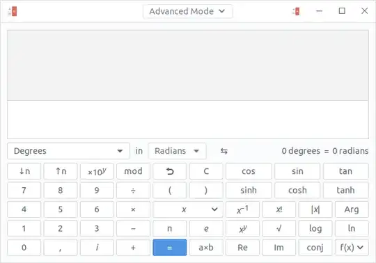

In order to place something in the left corner of the window title bar for all GTK and non GTK windows, you can modify the above command in this way (reference):
gsettings set org.gnome.desktop.wm.preferences button-layout menu:appmenu,minimize,maximize,close
Here is how the final result looks like for GTK and non GTK windows:
