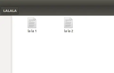

Directory Image
Directory Image
When I use dir command in terminal, the list of file show \ (backslash) to separate their word (see: Terimanal Image). Whereas in the origin, there is no '\' (backslash) (see: Directory Image). How do I change this back to normal?

What you experience is quoting, dir has the -N or --literal option to disable it:
-N, --literal
       print entry names without quoting
The exact same applies to ls, just that it quotes the whole filenames with single quotes instead of escaping special characters (which can be triggered with -b or --escape for ls as well). Calling ls with -N disables this behaviour as well.
Example run
$ touch 'la la '{1,2}
$ dir
la\ la\ 1  la\ la\ 2
$ dir -N
la la 1  la la 2
$ ls
'la la 1'  'la la 2'
$ ls -b
la\ la\ 1  la\ la\ 2
$ ls -N
la la 1  la la 2
