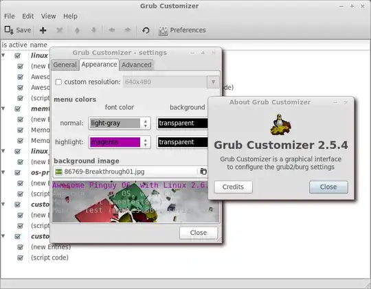

The best way I have found to manage the GRUB screen / resolution / text-size is to use "Grub_Customizer"
It works for GRUB and BURG both
Open a terminal and enter:
sudo add-apt-repository ppa:danielrichter2007/grub-customizer
sudo apt-get update
sudo apt-get install grub-customizer
then you can fully manage the GRUB screen
source
Ringtail
  • 16,285
I agree with "BlueXrider", however I could not get the ppa listed to work, so this is the one I would use:
it comes from the person that makes or manages the "Grub Customizer"
(Follow the same instructions from 'BlueXrider', just change the ppa in the instructions.)
