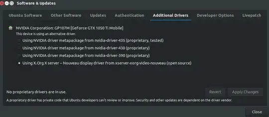

EDIT4: I'vs got some new stuff. I changed my GPU driver from a proprietary NVIDIA driver to X org X server (cf screenshot) and now suspend is working again. I'm not really sure if I will be able to use my GPU with this open source driver but at least I have identified a possible root cause of the problem. I tried sudo systemctl hibernate and it still doesn't work though but at least suspend is back to normal.
GPU driver changes
EDIT5: I tried all the nvidia drivers available on the GUI software&updates panel and one of them let me suspend my laptop without any trouble (the 390 one cf screenshot) enter image description here
So the question is now what's up with the Nvidia driver? Why hibernate is still not working ?
