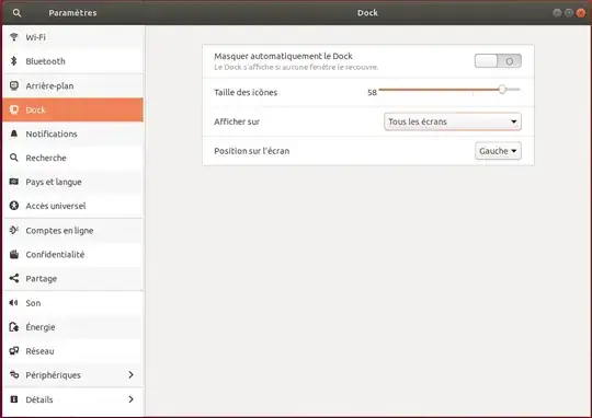

Go to Settings -> Dock
and select All screens inside Display on option (3rd lines)
you can see this option selected in my screenshot below (text are in French, sorry) :

Go to Settings -> Appearance -> Dock -> click on Show on dropdown -> Select All displays
And as @damadam said, for the top bar use https://askubuntu.com/a/1030468/829702
See Screenshot here: https://i.sstatic.net/ZnAEB.png
