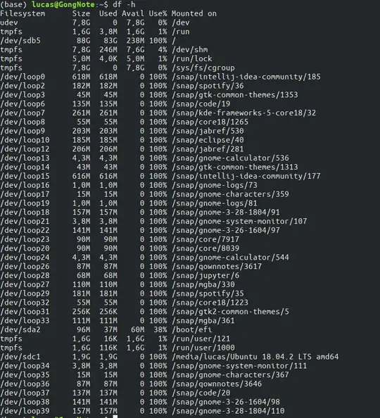

df -h:
df -h

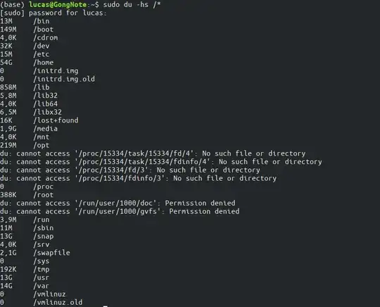

sudo du -hs /*:
sudo du -hs /*

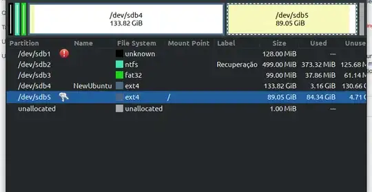

I want to take the partition on /dev/sdb4 and move to /dev/sdb5.
gparted screenshot
Actually I want to solve the problem of low space, I think this is how I can do it.
