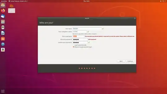

Is there a way to create a user with username admin?
When I tried to pick a username admin I got this error/ warning message.
The username you entered (admin) is reserved for use by the system. Please select a different one.

Sure, just comment out admin in the list of reserved usernames before launching the installer. You don't need to remaster the ISO for this, though you could if you wanted.
The graphical installer on the desktop ISOs for Ubuntu and most of its official derivatives is Ubiquity. This is the installer pictured in the screenshot shown in your question. It keeps a list of reserved usernames in /usr/lib/ubiquity/user-setup/reserved-usernames.
Boot from a live USB or live DVD. Select the option to try Ubuntu, rather than the option to install it, since you should modify that file before running the installer.
Then comment out the admin line in that file by placing # at the front of the line. One way to do this is to run this one command:
sudo sed -i.orig 's/^admin$/# &/' /usr/lib/ubiquity/user-setup/reserved-usernames
